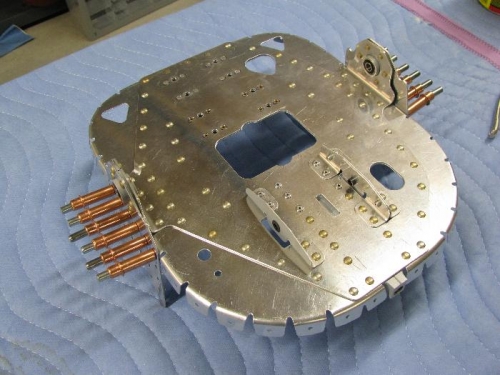

Brief Description:  Tail Cone Pg. 10-4 Rev.1 Stps. 1-9
Step 1: Riveted Attach Brackets together and pressed in bushings.
Step 2: Slightly flutted Bulkhead flange as required.
Step 3: Clecoed the the Fuselage Bulkhead to the Bulkhead Doubler.
Step 4: Clecoed the Tail Skid Bracket to the Bulkhead.
Step 5: Match-drilled the #30 holes into the Tail Skid Bracket.
Step 6: Final-drilled the #12 holes into the Bulkhead.
Step 7: Clecoed the Attach Brackets and Tail Skid to the Bulkhead Assy.
Step 8: Riveted the Fuselage Bulkhead to the Doubler.
Step 9: Riveted the Attach Brackets and Tail Skid Bracket to the Assy.
Fuselage Bulkhead 1
Fuselage Bulkhead 1
