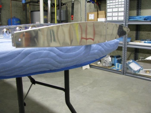

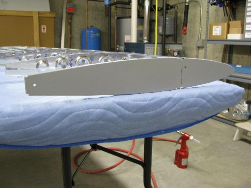

H. Stab Sec. 9
Deburred, primed, flutted and reriveted Fwd & Main Outbd Ribs.
Flutted lightly with 3 flutes between each hole to reduce waviness. Priming covers the remaining minor waviness.
Wavey end ribs
Smooth appearance
