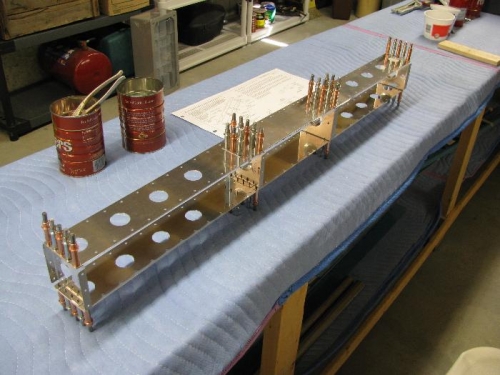

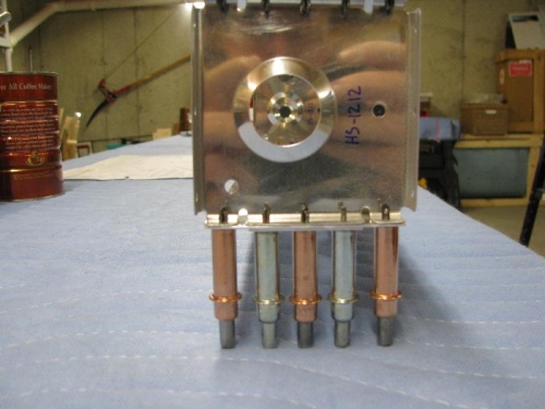

Clecoed and checked alignment of Inspar Ribs and Spar Caps. Riveted Spar Caps, Spacers and Inspar Ribs together. Added Fwd and Aft Spars to form the Spar Box Assy. Clecoed and drilled Upper and Lower Horn. Final drilled Counterbalance Bracket holes. Matchdrilled holes between Counterbalance Arm and Counterbalance Brackets. Deburred all holes. Riveted nutplate to Hinge Brackets. Fabricated four Hinge Stops. Separated and deburred Rib Clips.
Inspar alignment
Inspar alignment
