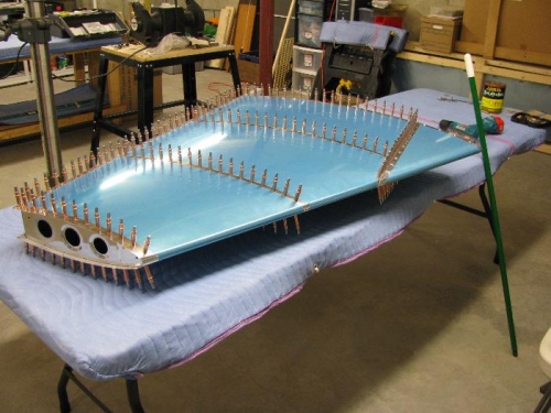

Date:  2-21-2009
Number of Hours:  5.50
Brief Description:  Verticle Stab. Pg. 6-7
Primed skins contact areas using Mar-Hyde Primer applied by foam brush.
Step 1, 3, 4 and 5. Clecoed the Main Skin to the V-Stab Skeleton. Fit appeared ok. Screwed Fwd Skin to V-Stab Assy. using AN507C832R8 screws.
Bolted Upper Hinge Assy. to V-Stab Assy. using AN3-5A Bolts, AN960-10 and AN960-10L Washers.
Attached bag containing Lower Hinge Assy., AN3-5A Bolts and AN960-10L Washers to V-Stab Assy.
Mop handle used to adjust ribs from both ends of V-Stab.
Clecoed V-Stab
Clecoed V-Stab
