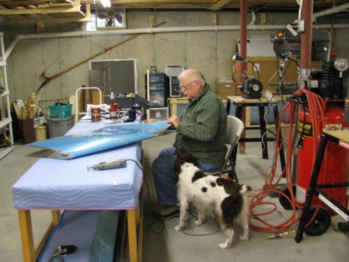

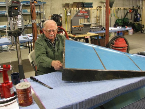

Date:  2-19-2009
Number of Hours:  7.00
Brief Description:  Verticle Stab. Pg. 6-6
Steps 3-4. Final drilled #19 holes in Fwd Skin and nutplate screw hole in Main Skin. Deburred Skins and drilled holes.
Steps 5-6. Dimpled #19 holes, using #8 dimple die, in Fwd and Main Skin. Step 7. Dimpled nutplate rivet holes in Main Skin using 3/32" die.
Step 8. Dimpled nutplate holes.
Deburring Main Skin
Deburring Main Skin
