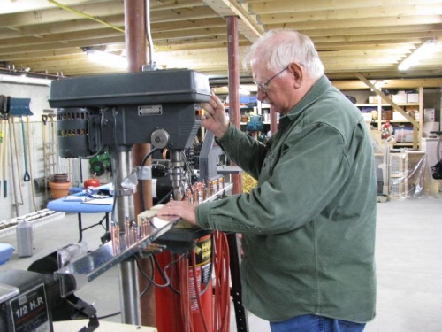

Date:  2-13-2009
Number of Hours:  7.50
Brief Description:  Verticle Stab. Pg. 6-3
Step 6-7. Match drilled #40 Nutplate rivet holes from Rear VSpar into Upper Spar Caps, also bottom holes of Rear VSpar into lower Spar Caps. Match drilled #12 holes of Rear VSpar into Upper and Lower Spar Caps. Deburred holes and cleared chips.
Primed Rear VSpar; Upper and Lower Spar Caps; Upper and Lower Hinge Assys.
Drilling  Rear VSpar
Drilling Rear VSpar
