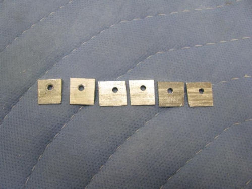

Completed steps 1-4. Fabricated 6 close quarters riveting wedges for use when pulling a rivet next an obstruction such as a flange on a rib. Trimmed and divided a 3" length of AEX into 6 equal parts. Drilled #40 hole for rivet mandrels.
Riveting Wedges 1
Riveting Wedges 2
