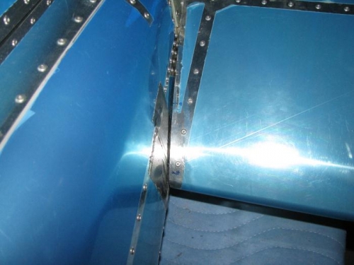

Step 12: Repeated steps 8through 10 with the Trim/Servo Assy fully extended.
Pg. 12-11
Step 1: Reinstalled the Tailcone with the screws.
Step 2: Checked for 1/8" clearance of the Rudder, Stabilator and Trim/Servo Assy to the Upper and Lower Tailcone Fairings. The leading edge of the Stab will be trimmed to get 1/8" clearance when it is next removed.

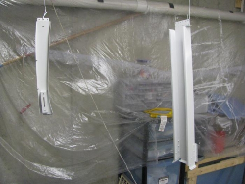

Removed the masking from painting the trim areas.
Final painted the Roll Bar Brace and Rt. Support Frame.
Area needing trim after Stab Removal
Roll Bar Brace & Rt. Support Frame
