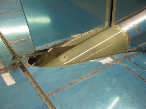

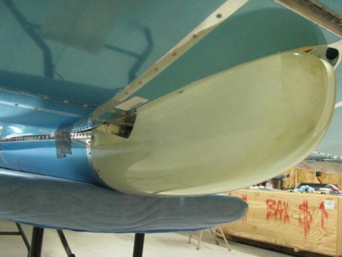

Step 9: Hooked up a battery and actuated Trim/Servo Assy. to the fully retracted position.
Step 10: Attached the Upper & Lower Tailcone Fairings to the Tailcone Assy.
Step 11: Checked the clearance between the Tailcone Fairings and the Tailcone Assy through out the operating range. Trimmed the upper fairing on bothe sides aft of the Spar Box hole. Trimmed the Upper & Lower Stab Skins on the rt. side. Enlarged the 3/4" hole on the Lower Fairing to accomodate the hinge of the Trim/Servo Assy. Removed the Tailcone Fairings.
Upper Tailcone Faing Check
Lower Tailcone Fairing Check
