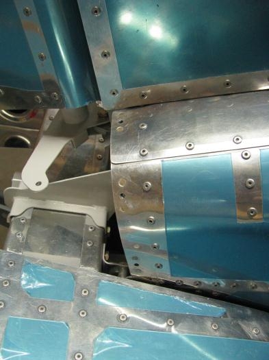

Step 4: Dimpled #40 the nutplate attach rivet holes in the Tailcone Assy.
Step 6: Riveted the nutplates to the Tailcone Assy.
Step 7: Drilled a 3/4" hole in the bottom of the Lower Tailcone Fairing.
Step 8: Installed the Trim/Servo Assy.
Nuteplates Riveted to the Tailcone Assy.
Installed Trim/Servo Assy.
