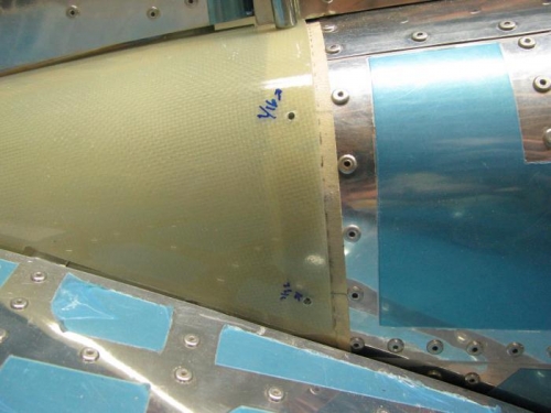

Trimmed the Stab Assy some more and trimmed Tail Cone Fairing (F-1294) to get clearance around the Spar Box. Had to adjust five holes in the Fairing to Tail Cone attach points as they were causing pillowing of the Fairing.
Some Holes Needing Adjustment
