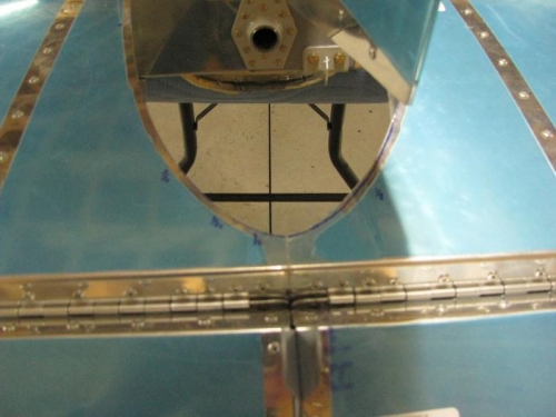

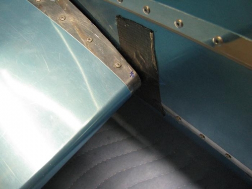

Continued fitting the Tail Cone Fairing to the Stab Assy Skin and around the Spar Box. The Leading edge of the Stab Assy is less than 1/8" clearance on both sides. Duct tape on the skin will protect against scratching the skin.
Areas needing trimming on Stab Skin
Note Tape to Protect While Mounting The Stab Assy
