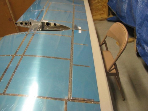

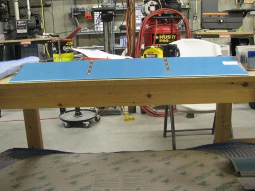

AST Trailing Edge Appers to Have No Twist

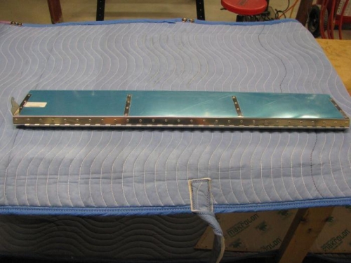

Completed New AST Left
New AST Left is a Good Fit
