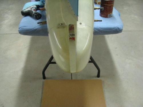

Step 5: Trimmed the aft slot to the scribe line in the Lower Tailcone Fairing.

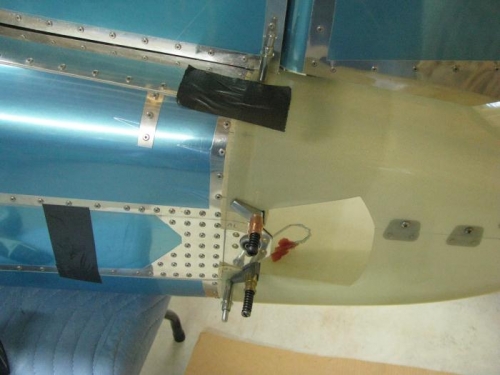

Step 1: Drilled a #40 hole in the Upper Tailcone Fairing at the inboard location marked on the "AL" masking tape.
Step 2: Drilled a #40 hole in the Lower Tailcone Fairing, but in the wrong location. Will have to drill the hole in the correct location inboard.

Aft Slot in Tailcone Fairing
Drilling Tailcone Fairing to the Tailcone
