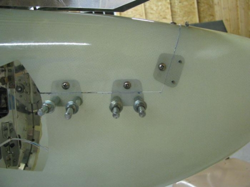

Step 1: Clecoed the 1294C Tabs to the Lower Tailcone Fairing. Temporarily screwed the Upper Tailcone Fairing to the Tabs.
Step 2: Marked, separated and sanded a gap between the Upper and Lower Tailcone Fairings.
Gap Sanded Between Upper and Lower Tailcone Fairings
