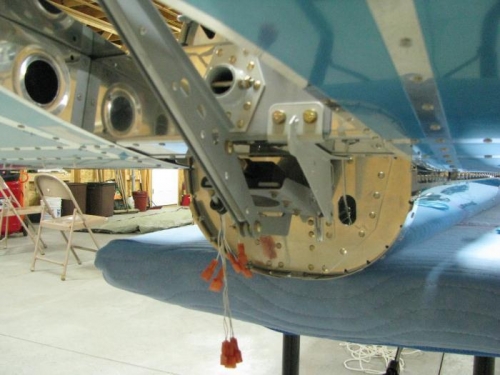

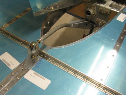

Step 8: Installed the Trim/Pitch Servo Assembly up between the Stabilator Skins to the AST Assembly Control Horns.
Step 9: Installed the Servo Tray to the Attach Brackets. Installed hardware with exception of the cotter pins which will be used at final attackment.
Step 10: Installed the rod end bearing to the AST Assy. Used a temporary bolt as I was out of AN3-10A bolts.
Pitch/Trim Servo Assembly
Servo Tray Attachment
AST Control Horn Attachment
