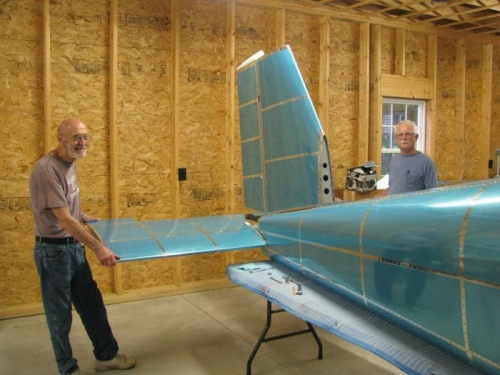

Step 1: Removed the AN4 bolt used to locate the glued washers, from the stabilator hinge brackets. Marked "top" on the Counterbalance Arm near the spar. Removed the hardware used to secure the Counterbalance Arm. With the weights rotated horizontally, installed the arm to the Stabilator Assembly.
Step 2: Rotated the Counterbalance Arm 90 degrees and inserted the weights through the hole in the Aft Bulkhead. Rotated the Counterbalance Arm to the original position and installed hardware.

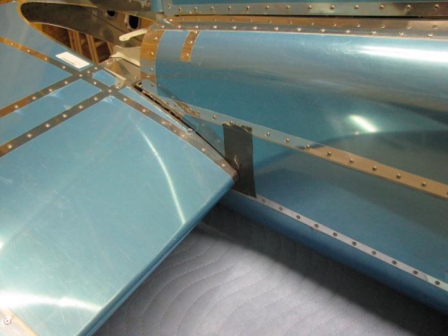

Step 3: Added duct tape to the Tailcone Skins to prevent scratching from the forward Stabilator Skin. Installed the Stabilator Assy to the Tailcone Assy.
Step 4: Checked Stabilator Assy movement through its operating range to assure free operation and limited by the hinge stops.

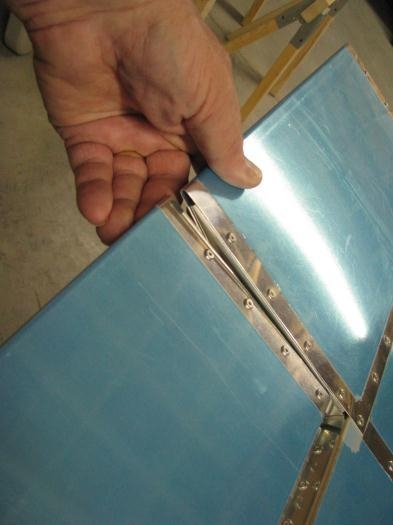

Step 2: Installed the Left and Right AST Assemblies to the Stabilator Assy using the hinge pins.
Step 3: Attached the AST Assemblies together. Checked freedom of movement and alignment. The left end of the Left AST Assy was misaligned by a 1/4". Will refabricate the assy when parts arrive.

Neighbors Russ and Dave helping to install the Stabilator
Duct Tape Used to protect the Tailcone Skin
Misalignment of the Left AST
