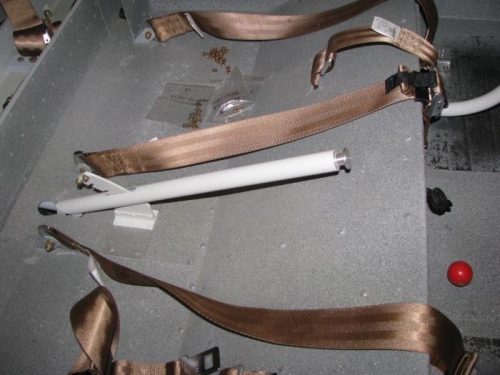

Step 2: Removed Detent Bracket Assy. and slipped Seat Floor Cover over the Flap Handle. Attached the Seat Floor Cover to the Seat Floors, Then screwed the Detent Bracket Assy.to the Seat Floor Cover.
Step 5: Removed the VA-104-3 Knob and fasten the F-1227 Seat Ramp Cover and F-1214 Step Floor Cover, then reattached the Knob.

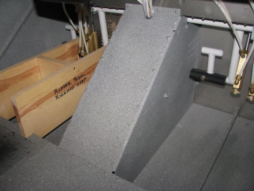

Step 5: Installed F-1217B-L&R Rudder Peddal Access Covers.
Step 7: Installed the F-1230 Tunnel Cover.

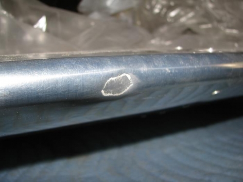

Fig. 2: While removing the Stabilator, I noted a dent in the leading edge of HS-1201R Man Skin. It measures 5/8" x 3/8" x 1/16". There were no cracks. I don't know how or when it happened as it was covered to keep it clean. Van's Support recommended replacing the Main Skin.
Flap and Seat Ramp Covers
Tunnel Cover
Tunnel Cover
