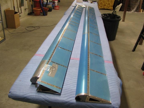

Brief Description:  Wing Flaperons Pg. 18-6
Right Flaperon
Step 4: Clecoed the Inbd Nose Skin to the understructure. Match drilled the #30 holes.
Step 5: Removed the Inbd Nose Skin and deburred the drilled holes.
Step 6: Placed the Rod End Bearings in a plastic bags and taped them to the Flaperons for later assembly and to keep them clean.
The Wings, including flaperons are complete.
