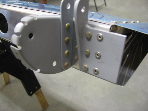

Pg. 18-5 Left Flaperon
Step 1: Riveted the Actuation Bracket and Pivot Brackets to the Spar. I oriented the shop heads fwd on the Actuation Bracket since the location of the radius of the leg on the bracket would not allow a flush fit of the manufactured head on the rivet. I installed them with a 2X rivet gun to avoid marring the bracket with squeezer.
Step 2: Clecoed and riveted the Main Ribs to the Spar, leaving the 5th and outbd ribs unclecoed.
Step 3: Clecoed the Nose Rib Bracket Assy, Inbd Nose Rib, last two Main Ribs and the outbd Nose Rib/Counter Balance Assy to the Spar.
Step 4: Riveted the assembled parts to together.

Riveting Actuation Brack.
Brackets riveted
Brackets riveted
