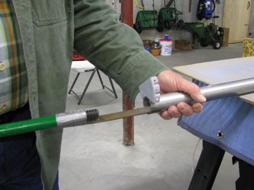

Step 5: Match drilled #30 the holes in the upper flanges of the Outbd Nose Ribs. Completed the #30 match drilling by removing the Aileron Counterbalance pipe from the assy. to a vice where I drilled the #30 holes using a hand electric drill. I used a sharp bit; slow speed; lots of oil and moderate pressure on the drill. SS is hard material.
Step 6: The parts being unclecoed, I deburred the holes I just drilled. The holes in the Aileron Counterbalance were deburred using a half round file taped to a rod to reach inside the pipe.

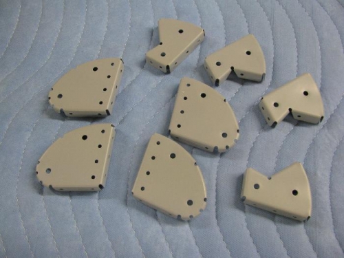

Step 2: Deburred the Inbd Nose Ribs. Clecoed the Bracket to the Inbd Nose Ribs.
Step 3: Riveted the bracket to the Inbd Nose Ribs.

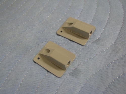

Step 4: Clecoed the Pivot Brackets, Inbd Nose Ribs and Bracket Assy to the Spar.
Step 5: Used a standard hardware bolt and nut (10-32) through the A-1208 Bracket and the Actuation Bracket with 8 AN960-10 washers to establish the correct spacing for the Actuation Bracket.
Step 6: Aligned the Actuation and Pivot Brackets with the top edge of the Spar and match drilled into the spar and clecoing the drilled holes.
Step 7: Removed the Pivot Brackets, Actuation Bracket and Nose Rib Bracket Assy for deburring.
Step 8: Deburred all edges and holes. Primed the Pivot Brackets, Actuation Bracket and all Nose Ribs
Deburring Counter Bal.
Primed Nose Ribs
Primed Nose Ribs
Primed Pivot Brackets
