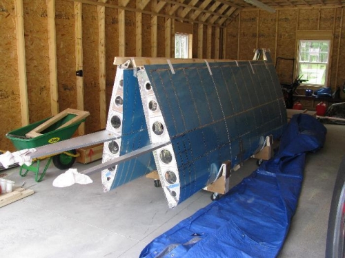

Step 2: Clecoed and riveted the Right Wing Tip Close-out in place.
Step 3: Clecoed the Wing Tip Trailing Edges to the Wing Tip Close-outs and Tip Ribs to verify a parallel condition with the trailing edge of the wing. Match drilled #30 the holes to the Wing Tip Trailing Edge. Riveted the Wing Tip Trailing Edge to the Wing Tip Aft Skin, Wing Tip Rib and Wing Tip Close-out for both wings.
Step 4: The steps for both wings were done together.

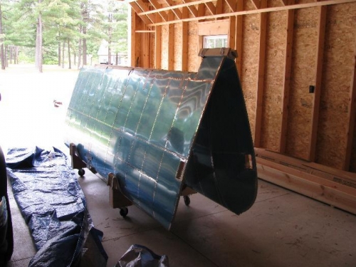

Wings are complete. Move them out of the basement into the hanger. Added lots of protection from bumps and scrapes as it was a tight fit getting out the bulkhead. On to the Flaperons
Wings on the rack
Wings on the rack
Wings in storage
Wings in storage
