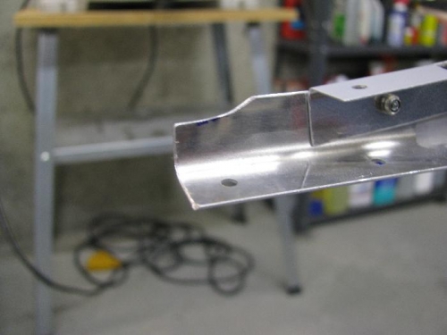

Step 4: Riveted the Wing Tip Ribs to the Wing Tip Aft Skins and Wing Tip Fwd Skins for both wings.
Step 5: Fluted and riveted the Fwd Wing Tip Rib to the Wing Tip Fwd Skin and Aft Wing Tip Rib for both wings.

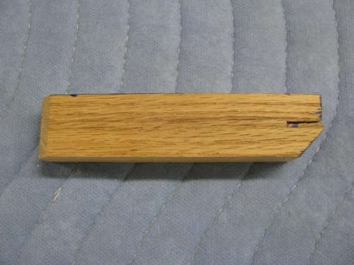

Step 1: Fabricated the bending tool for the Wing Tip Close Outs from a piece of scrap oak. Bent the tabs for the Left Wing.
Step 2: Clecoed and riveted the Left Wing Tip Close-out in place.
Fwd Tip Rib
Fwd Tip Rib
Relief of Rear Spar
Relief of Rear Spar
Bending Tool
Bending Tool
