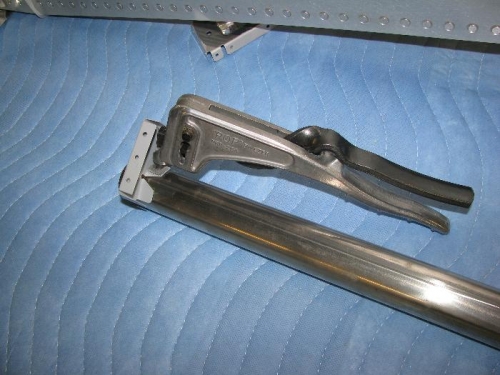

Step 1: Clecoed the Spar , Outbd. Nose Ribs, Counterbalance and Outbd. Nose Skin.
Step 2: Match drilled #30 the the Most Inbd. and most Outbd. Nose Ribs using the technique previously decribed.
Step 3: Unclecoed the assy. and deburred the holes in the Counterbalance.
Step 4: Riveted the Lt. and Rt. Counterbalance Weights to the Outbd. Nose Ribs. Used the wedge technique to pull the rivets with the close quarters hand riveter.

Riveting Nose Rib
Riveting Nose Rib
