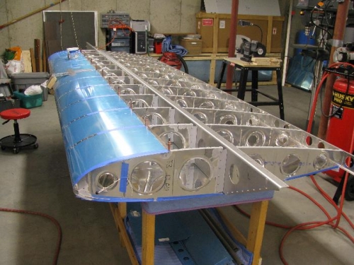

Step 1: Three of us flipped the wings and skins were secured on upper skeleton with clecoes.
Step 2: Riveted the called out holes on the upper skins, leaving open the remaining holes.
Step 3: Clecoed and riveted the Hinge Bracket Assys. to the Lower Skin, Aft Spar and Hinge Ribs.

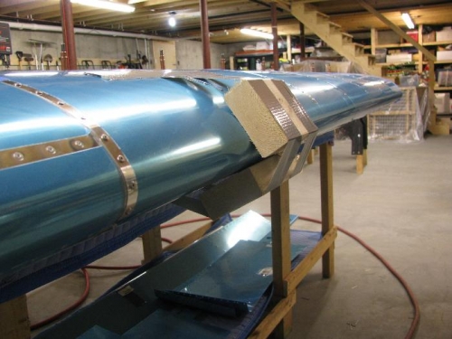

Step 5: Dimpled holes and riveted nutplates for Stall Warning Access Hatch.
Added protection for the Stall Warning tab.
Flipped Left Wing
Flipped Left Wing
Stall Warning Protection
