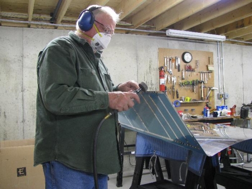

Deburred Bottom Left Wing Skins.
Step 1: Placed the left wing skeleton upside down on a table covered with moving blankets.
Step 2: Dimpled the inbd wing skin, then clecoed and riveted the skin except for the outbd edge and called out holes.
Step 3: Using a unibit , enlarged the #30 hole to 3/8" for the tie down ring.
Deburring wing skin
Deburring wing skin
