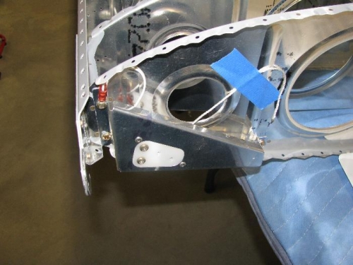

Pg. 16-4
Step 1: Cut 2, 12' lengths of string.
Step 2: Routed the strings through the Snap Bushings and taped the ends.
Step 3: Attached a connector to the inbd end of the Terminal Wire.
Step 4: Made 2, 5" Terminal Ground Wires and attached connectors.
Step 5: Attached the Terminal Wire and the Ground Wire to the L Terminal Bracket.
This concludes Section 16.
Step 6: Attached the other Ground Wire to the R Terminal Bracket.
Step 7: Installed the Terminal Brackets onto the Outbd Nose Ribs.
Step 6:
Terminal Bracket
Terminal Bracket
