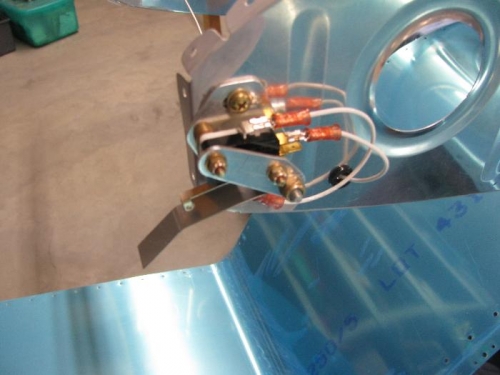

Brief Description:  Stall Warning Pg. 16-2, 16-3
Pg. 16-2
Step 1: Final drilled the #30 holes in the Mount Plate and Keeper Plate. Machine Counter sunk holes in Mount Plate for #4 screw.
Step 2: Final drilled and countersunk the #19 hole in the Mount Plate and Keeper Plate for the #8 screw.
Step 3: Deburred the holes and edges.
Step 4: Assembled the Stall Warning Assy.
Step 5: Removed bending tabs from Terminal Brackets. Deburred the holes and edges.
Step 6: Trimmed and match drilled the #40 holes in two PS UMHW blocks using the drill template. Final drilled the #30 and #19 holes in the blocks.
Step 7: Riveted the Terminal Blocks to the outside of the Terminal Brackets.
Pg. 16-3
Step 2: Installed the Stall Warning Assy. Using 5 thin washers inbd of the Microswitch and 4 outbd. These were the washers provided in the kit.
Step 3: Clecoed the Mid Wing Skin over the Nose Ribs.
Step 4: Adjusted the Sall Warning Assy. to activate with minimum movement. The arm on the microswitch was bent down slightly to acheive the adjustment.
Step 4:
Stall Warning Assy.
Stall Warning Assy.
