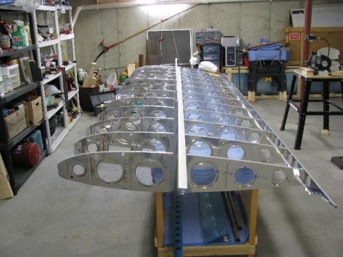

Date:  4-28-2009
Number of Hours:  5.50
Brief Description:  Wing Ribs Pg. 15-5
Step 1: Starting Outbd, clecoed and riveted five aft trimmed L Nose Ribs.
Step 2: Clecoed and riveted an unmodified R Nose Rib, then an R Nose Rib with nutplates and finally another unmodified R Nose Rib.
Step 3: Clecoed and riveted four fwd trimmed R Nose Ribs.
Step 4: Clecoed and riveted the fwd trimmed L Nose Rib.
Step 5: Clecoed and riveted the fwd and aft trimmed R Nose Rib with the nutplates to the last attach angle.
