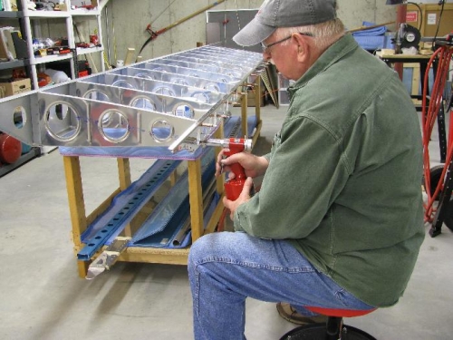

Brief Description:  Wing Ribs Pg. 15-3, 15-4
Pg. 15-3
Step 8: Riveted the Rib Doublers to the L Main Ribs.
Step 9: Riveted the Rib Doublers to the R Main Ribs.
Pg. 15-4
Step 1: Clecoed and riveted an R Main Rib to the outboard attach angle on the L Spar Assy.
Step 2: Clecoed and riveted a match drilled R Main Rib to the next attach angle.
Step 3: Clecoed and riveted four more R Main Ribs.
Step 4: Clecoed and riveted the other match drilled R main Rib to the attach angle.
Step 5: Clecoed and riveted five more R main Ribs to the Spar Assy.
Step 6: Clecoed and riveted the L Main Rib with the Rib Doubler to the last attach angle.
Step 7: Clecoed the Aft Spar Assy. to the Main Ribs.
Step 8: Match drilled the two #30 holes into the aft flange of the inbd L Main Rib. Removed and deburred.
Step 9: Clecoed and riveted the Aft Spar Assy. to the Main Ribs.
Aft Spar Assy.
Aft Spar Assy.
