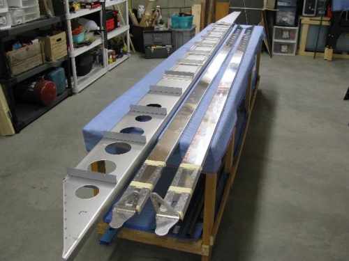

Brief Description:  Rr Spr, Stb Spr, Hng Brk Pg. 14-2, 14-3
Pg. 14-2
Step 10: Riveted the Flaperon Hinge Brackets to the Hinge Plates in a ramdom pattern. Took caution with the flush rivets, not squeezing the rivets completely to avoid binding the bearings.
Step 11: Separated the Tip Attach Angle and Identified.
Pg. 14-3
Step 1: Clecoed the Hinge Assys. to the Rear Spar Doubler Plates.
Step 2: Riveted the inboard flange of the Hinge Assys. to the Doubler Plates.
Step 3: Clecoed the Doubler Assys. to the inboard end of the Rear Spar Web.
Rear Spar Assys.
Rear Spar Assys.
