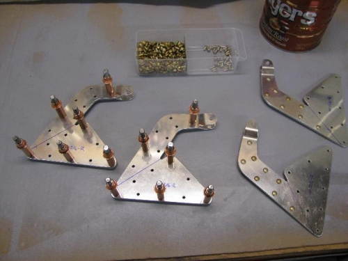

Step 5: Clecoed the L&R Flaperon Hinge Brackets together.
Step 6: Riveted the Hinge Brackets together in a random pattern.
Step 7: Machine Countersunk two holes in each Hinge Bracket.
Step 8: Pressed Bearings into Hinge Plates using a 7/16" and 5/8" Socket.
Step 9: Clecoed the Hinge Plates and Hinges together, pressing the bearings into the hinges.
Hinge Brackets
Hinge Brackets
