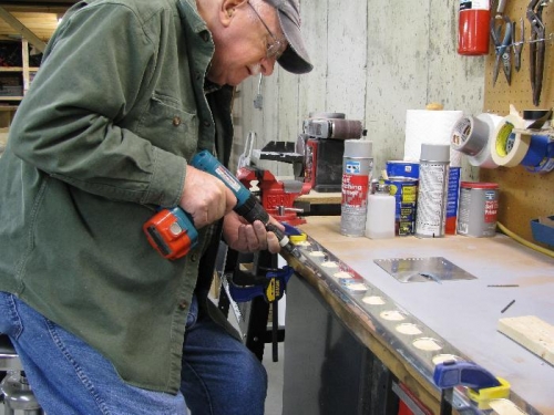

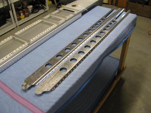

Step 2: Machine Countersunk 120 degrees the Stub Spar Channels.
Step 1: Clecoed the Stub Spar Doublers to the Stub Spar Channels.
Step 3: Machine Countersunk 100 degrees the the inner hole of the Stub Spar Assys.
Step 4: Riveted the Stub Spar Assys. with three flush rivets at the inboard end.
Machine Countersink
Machine Countersink
Cntrsinking Stub Spars
Stub Spars
Stub Spars
