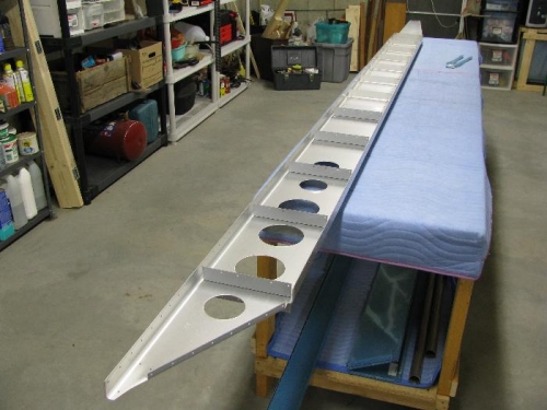

Performing Assembly of both wings at the same time.
Deburred & primed W-1210B-L&R, W-1206-V's, & W-1206-T's.
Pg. 13-2
Step 1: Separated 20 Attach Angles.
Step 2: Separated the Rib Doublers.
Step 3: Clecoed the Rib doublers to the Spar Assy's.
Step 4: Used a 6" #30 drill to match-drill the first row of holes from Attach Angles into the Rib Doublers.
Pg. 13-3
Step 1: Attached the 1206V Attach Angles to the Spar Assys.
Step 2: Clecoed the 1206T Attach Angles to the outbd. end of the Spar Assys.
Attach Angles
Attach Angles
