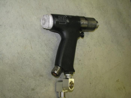

Step 36: Attached the Drill Template to the top side of the Center Section Assembly with the Out board Main Gear Attach Bracket, Outboard Doubler Plateand Outboard Wear Plate to the lower side of the Center Section Assembly on the right main gear. Note: Used the Template for hole location only.
Step 37: With the aircraft leveled and using a drill with a bubble level attached, match-drilled #30 the two .125 holes called out in Figure 17, through allthe parts.
Removed the template and repeated this step on the left side.
Step 38: With the bubble centered on the bubble level, drilled 1/4" both holes that were #30 match-drilled. Removed the parts marking their orientation.
Step 39: Repeated the drilling process on the other side. Removed the parts noting their orientation and location.
Step 40: Deburred the 1/4" holes in the Center Section, Outboard Doubler Plates and Outboard Wear Plates.
Step 41: Cleaned up the drill shavings.
