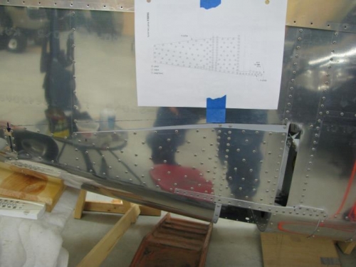

Step 31: Riveted the Side Skin Doublers to the fuselage structures using the Rivet Callout Sheet.
Step 32: Beveled the four corners the U-1202 Outboard Main Gear Attach Brackets, Fig. 15 and also SB 12-09-2.
Step 33: N/A. Aircraft not flown yet.
Step 34: Deburred edges of U-1202C-B Outboard Doubler Plates and U-1202D-B Outboard Wear Plates.
Step 35: Removed the blue vinyl from the F-1204V Drill Template.
