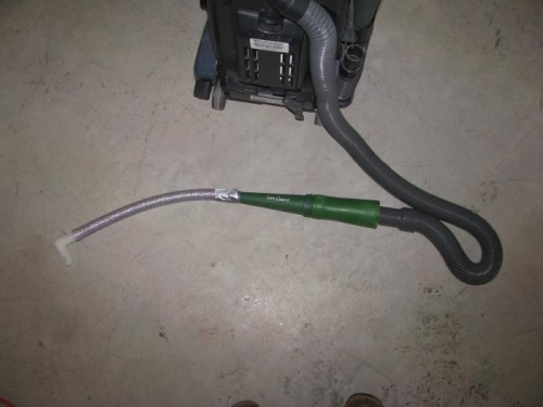

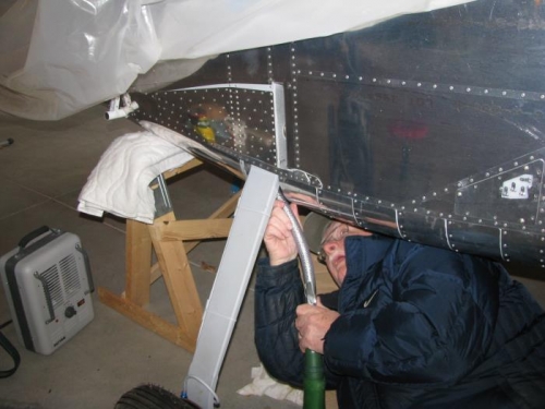

Step 29: Vacuumed the rivet tails and drill shavings from the interior of the fuselage.
