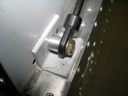

Installed oversized Gas Strut Bushing and Canopy s
Page 34-02
Step 1: Drilled out the aft Gas Strut holes to 3/8" .
Page 34-03
Step 1: Installed the new C-00002 Bushings between the gas struts and fuselage on both sides.

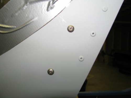

Step 2: Re-drilled 3 holes on both sides of the fuselage where they were previously removed. Installed the screws, washers and nuts.
