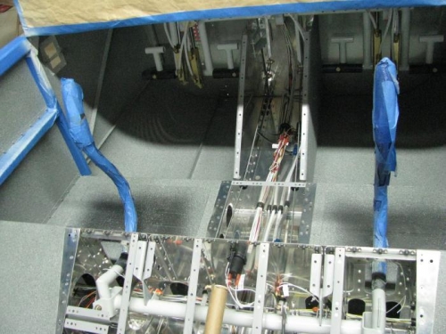

Torqued and sealed the Control Stick push rod bolts. Inserted cotter pins in the Control Stick swivel bolt/nut assemblies and the Stabilizer cable to Control Column bolts.
Pg. 24-06
Step 4: Riveted the F-1254 L & R Support Frames to the Roll Bar Assembly and F-1234 L & R Canopy Decks.
Pg. 25-05
Step 1: Clecoed the F-1277 L& R Fwd Turtle Deck Skins to the Fuselage and Tail Cone Assembly.
Control Columns installed
