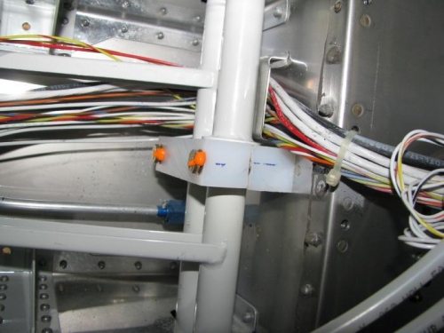

Torqued bolts/nuts on Torque Tubes and Torque Arms. Used torque seal on all nut and bolt torqueing.

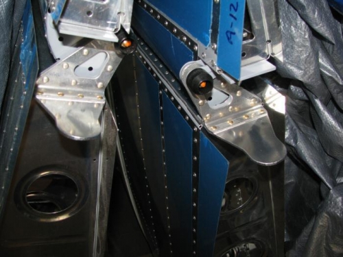

Replaced the lower bolt in the Rudder Hinge Assy with a AN3-10A bolt. I ran short of 10A bolts and ordered more. Torqued the nuts on the top and bottom hinges and torque sealed.
Tightened the bolts on the Rudder Pedal Assy attachments and torque sealed.
Replaced Lower Rudder Hinge Bolt

Tightened Bolts on Rudder Pedal Assy
