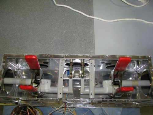

Step 1: Applied clamps to align the Flaperons with the trailing edge of the wings.
Step 2: Flushed the ends of the Flaperon Torque Tubes with the brackets on the Flaperon Torque Arms.
Step 3: Inserted the .063" spacers between the Flaperon Torque Tubes and Flaperon Torque Arms then clamped them together.
Step 4: Match drilled #30 the two top hole of each Flaperon Torque Arm into the Flaperon Torque Tubes.
Step 5: We removed the wings with much difficulty extracting the pins. there was a lot of wiggling the wings while twisting the pins. Also removed the Flaperon Torque Tubes and Torque Arms. Next time the pins will be lubricated.
Step 6: Went back to the work bench in the basement, where I clecoed the Flaperon Torque Tubes and Torque Arms using the .063" spacers and the previously drilled holes. then clamped them together.
Step 7: Match-drill the #30 holes on the other side of the Flaperon Torque Arms.
Step 8: Final-drilled #12 all the way through both sets of holes.

Torque Tubes Clamped to the Torque Arms
