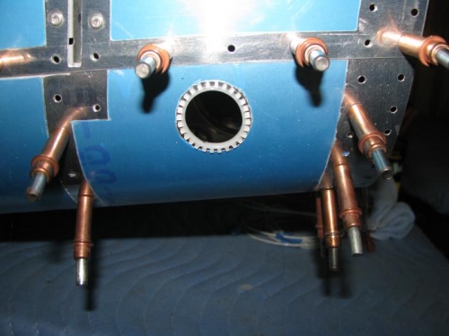

Pg. 32-09
Step 1: Cut two MS21266-1N Nylon Grommets to 3-3/4" length and installed them around the edges of the holes in the Baggage Corner Skins.

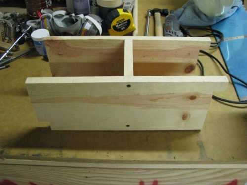

Pg. 32-11
Step 8: Using wood from my shipping crates, I fabricated the Rudder Pedal Rigging Stop as shown in the plans
Nylon Grommets installed
