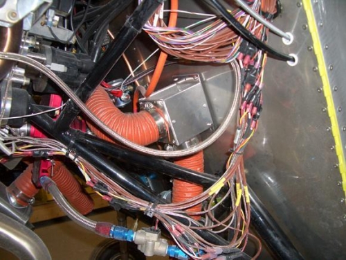

Brief Description:  Cabin heat control, right cowling inlet
Changed fuel filter to lagrer 3/8" size. Feel much better about that now. Cut hole in right cowling and flush riveted the naca inlet for cabin heat air inlet to heat muff. Finished connecting cabin heat push/pull control to cabin heat switch box with stainless clamps on engine mount. Good positive on/off push/pull control works really nicely.
