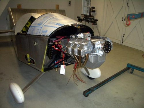

Date:  3-1-2008
Number of Hours:  12.00
Brief Description:  Mounted Engine

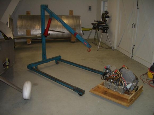

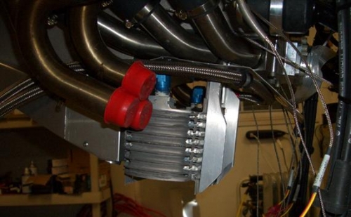

Rented a "cherry picker" real cheap and smoothly & cleanly mounted the engine. Went very well, took my sweet time. Will need to change mounting bolts to better AN bolts I didn't have at the time. No problem. Put together parts list to order items missing for install. Worked on oil cooler mounting brackets, baffling for oil cooler. Attached hoses to oil cooler. Mounted and attached all 12 CHT and EGT sensors to cylinders & exhaust and routed them. Trimmed #1 cylinder fins for cowling clearance. Hooked up new master & starter relay/solenoids and everything works well. Getting very close to cowling/canopy/painters and then off to the airport!
