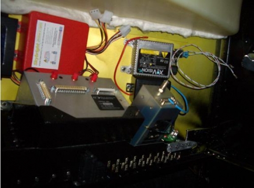

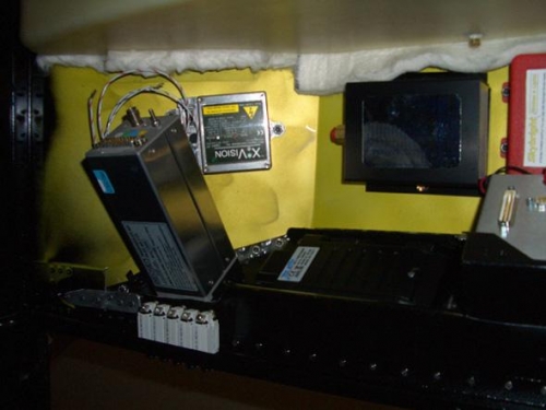

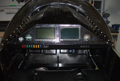

Brief Description:  Installed panel & other modules
Decreased number of switches by 3, replaced that space with elt interface over 3 switch holes, came out good. Fully riveted and mounted the cross-tie and switch/breaker panel. Added 1/8" thick reinforcing splice plate to compensate for material removal clearance of radio and xpdr. Then fully mounted and screwed in instrument panel. Very tight fit, black button heads look good, a lot of extra work (should have just riveted?). Then - mounted strobe & 2 landing light power supplies under glareshield in available space, Plus power filter for com, & altitude encoder for xpdr. All instruments and modules behind firewall are fully & finally mounted and everything is ready for wiring! Starting to look awesome. Time to connect the dots.
