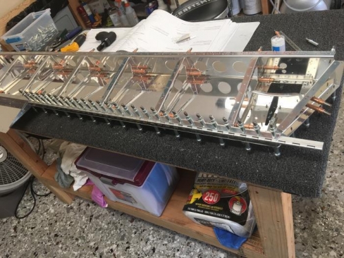

The E-01403 trim tab forward hinge is match drilled to the upper rear spar of the elevator. The hole drilled on the outboard end of the hinge in a previous step is used to position the hinge onto the rear spar. I used a number of 1 in. clecko clamps to position the hinge along the edge and drilled all the holes. There isn't much distance between the upper and lower flange on the rear spar and on the first couple of holes the drill tip hit the lower flange and put a small gouge in it. It's not a big deal, but I'll have to blend it out before I prime. The hinge overhang is trimmed off and deburred.

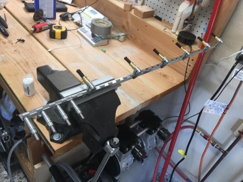

The process is repeated with the aft hinge and the trim tab spar. No problems so far. As a check, I joined the hinges back together with the hinge pin and there was no binding.

Fwd portion of the trim tab hinge match drilled and cleckoed into place. Excess hinge is trimmed away.
Trim tab spar and aft hinge getting match drilled
