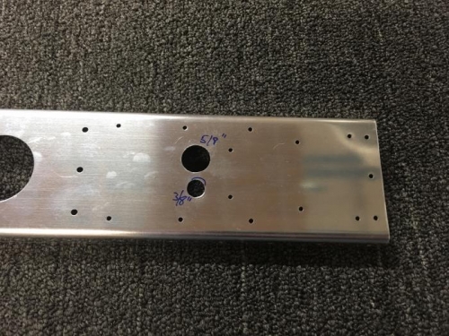

The E-00902-1L front spar gets a 3/8 in. and a 5/8 in. hole for the trim servo motor wiring. This was my first time using a step drill and the 3/8 in. hole got a bit of a chamfer because I didn't control the drill as well as I should've. This hole doesn't get a fastener so I think if I just remove the knife edge it should be OK. I'll double check with Vans before I do anything just to be sure.
(Update 8/29/18: Just talked to Vans builder support this afternoon. He confirmed the small 3/8 in. hole remains open. Its function is to allow the trim servo actuator a path as it moves the trim tab up and down. It doesn't really matter if the hole is perfectly round.)
The 5/8 in. hole was much better. This hole gets a snap bushing later in the build.

These are pass-through holes for the electric trim servo wiring. The large hole gets a snap bushing.
