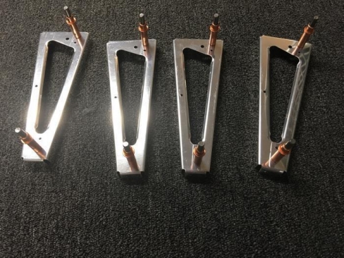

The whole thing with the counterbalance ribs was for some reason very demotivating. I couldn't bring myself to skip that step and move on. Eventually I forced myself to go to the shop and do something, no matter how small.
I finished the deburring of the metal ribs and clecko'ed them together. Then I started working on the foam trailing edge ribs. In the end you have eight trailing ribs (E-00924) and three trim tab ribs (E-01408). First you glue on a template, then cut the ribs out of the foam and finish them to final size on a belt sander.
I started doing this but quickly found out the foam clogs up my belt sander. I got one rib done and found the sander to be ineffective for the next one. I tried to scrape the foam dust out of the sandpaper belt but that was only partially effective. It looks like I'll need to buy some additional belts for my sander. I put the rest aside to finish at a later date.

Cut, deburred and temporarily fastened together.
