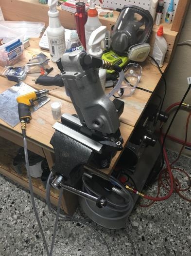

Tonight was a short session. I dimpled the rudder stiffeners using the substructure dimples. These make a dimple 0.007 in. deeper than the regular dimples which gives you a better fit.

Clamping the pneumatic squeezer in a vise made this job easier.
