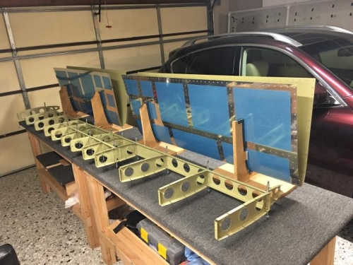

Brief Description:  Rivet inspar and nose ribs to the front spar
The two outboard nose ribs, the spar web assembly and the rest of the inspar ribs were riveted to the front spar assembly. Things went together smoothly for the most part. I had to drill out a couple of rivets when I mistakenly squeezed them into the wrong hole, but they came out without problems.
One of the nose ribs was riveted on the wrong side of the spar, but I fixed it without too much trouble.
The internal structure is now ready to be riveted into the skin assembly. I'll get that prepped tomorrow evening and the riveting is scheduled to be done Sunday. Jay will come back and help me finish this part of the build.
Front spar and ribs ready to be set into the skins for final riveting.
